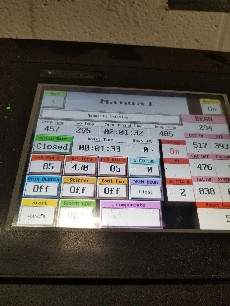

I will write about my experience on the revelation after I have spoken to the manufacturer. I played on one a little bit a couple of weeks ago. I just want to understand the controls a little better before I give my thoughts. The one I used was BIG. Only a 70 kilo but massive compared to my 60 kilo Ambex.
View attachment 9492View attachment 9493View attachment 9494
