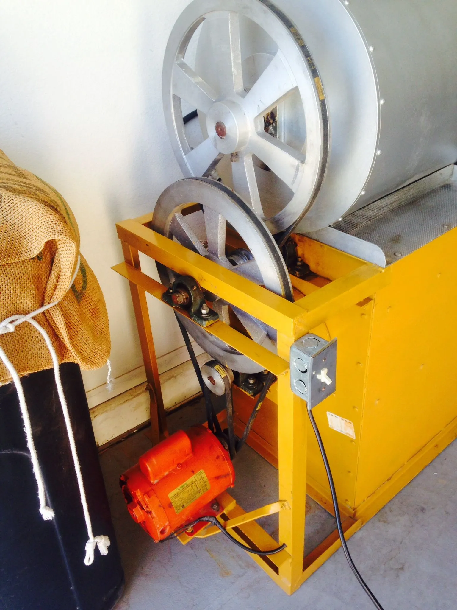

image.webpInteresting you mention Guatemala. I just met a nice gentleman in his 70's here today in the Phoenix area that grew up in the coffee growing mountains and grew his own coffee as well as roasting it for decades. He has a nice solid 10 lb. roaster that he had custom made in Guatemala that is pretty much a manual system. The thing looks like a tank and he has offered to sell it for a few grand. Seems like a great deal if I can just find a safe place to use it. Looks to be almost 100% cast iron... Do you all think its worth the effort? It appears to be made by an actual company in that country. It had a company name tag on it but if forgot to write it down. Built about 2006/7 and used about 10-15 days.

By the pics- I would say it does not appear to be cast iron. More of steel construction. Not that that is a bad thing.
Questions: I would ask about chaff collection, is there a collection box underneath the machine with easy access?
Is there a cooling fan and stirring arm in the cooling tray?(cannot tell by the pics).
Also, access to the burner(cannot tell by pics). It looks to be propane by the hookup in one photo.
Is the burner cast iron?
Looks new, may be worth the pursuit. Also, could you see it operate? Just a few thoughts.
I am going to assume that it doesn't have stirring arms. The cooling bin is square if it had an agitator it wouldn't cool evenly. I do not see a way to adjust the airflow. If you can not adjust the airflow it would be a deal breaker for me.
For a few grand it might be worth it. You will not see the best results out of it but it is a starting point.
image.webpimage.webpimage.webpimage.webpimage.webpIt does not have a fan or arm in cooling tray. Cooling is done manual in tray with wood paddle . The chaff container is under drum and easy to get to plus owner is offering a steel cyclone with it that has many steel pipes not shown in pics. There is 5-6 burner valves that attach under drum and can be viewed while roasting. I did not see any air flow controls. Not sure where to look for these. Only openings I can see into drum are where beans are loader through hopper and door to let beans out... This thing is a tank! I'm not sure I could use it in just any building???
did not see operate because in residents garage. The only real control I can see is temp. Guage and control for flow of propane to burners to adjust heat manually...

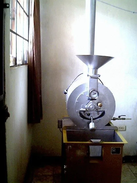

Colonia Roosevelt Hecho en Guatemala centro America (only found one other on the web that cooked 25 lb at a time. This one does 10. Owner said only used about 10 times to roast about 100 lb)
the picture above of large roaster is the 25lb. One that sold for $15,000 used a couple years ago.

I would pass on that roaster. If you can't control your roast what's the point.

Thanks for the encouragement. I just found the Guatemalan Company on Facebook. It appears they still make & sell these machines. I'm uploading a couple of their current units which look similar and mostly manual. (This is a much larger unit 25lb. But has some of the same features this 10lb. Unit has.)
