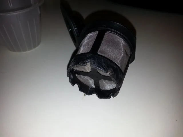

I also adapted that same sort of style, to converting a k-cup reusable filter, and once again it works perfect.
Solofill has their V1 filter for the Vue, at about $25 a piece with shipping. I picked up four of the k-cup reusable filters at my local Fredmeyer for $10, and modified each to be useable in the Vue. Works perfectly.

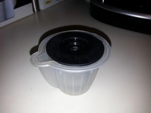

Also, here are some images of what I did with the reusable k-cup, to convert it to being usable with the v-cup.
The v-cup in the pic, is the larger v-cup, since it will accommodate the reusable k-cup filter the best.
A whole was drilled in the top of the k-cup filter to accommodate the v-cup needle. The bottom of the k-cup was cut shorter to fit flush with top of the v-cup, when put inside the v-cup, and notches were cut along the bottom of the k-cup to allow for the liquid to flow. All work was done with a Dremel multi-tool.
