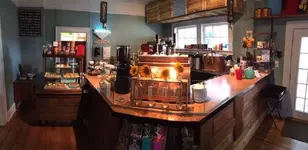

We bought a Victoria Arduino Athena Leva 2 Gr. two years ago for our coffee shop. We absolutely love it! Not only is it a solid performer for us but the maintenance is super easy. I also love that it is a piece of artwork. I find the simplicity of it makes teaching our baristas to be a more direct process than with a pump machine. Historically, there is much less "fine tuning" of the grinder with the Leva than with a pump machine. If I had to do it all over again, I would purchase a Leva again!
It's not an ideal picture but it helps to show it. It holds the anchor on our counter when you come in our shop. I just grabbed this from our FB page.
- Micah
