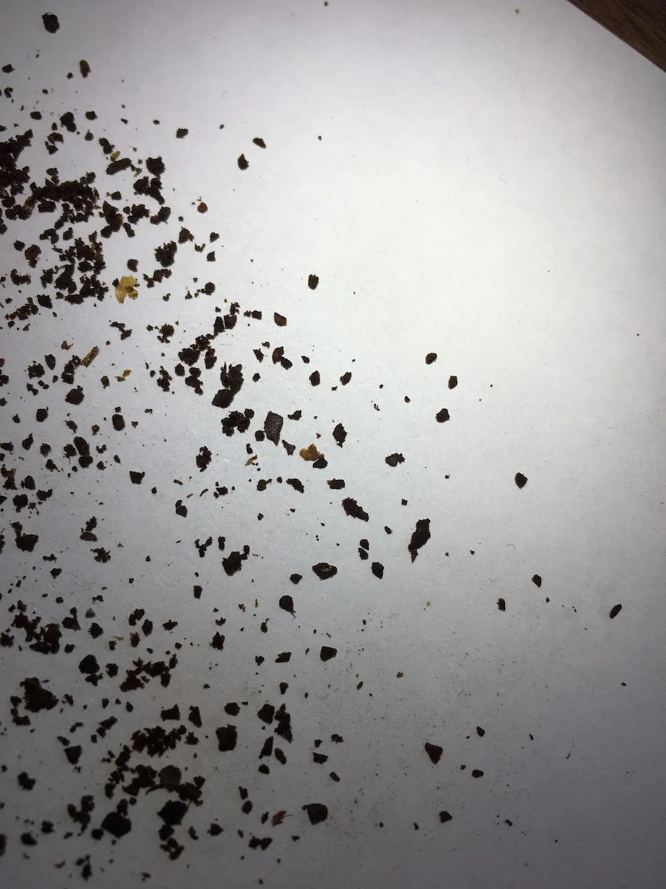

1. My DCP does seem to spit out quite uneven grounds when grinding at the upper end of its range for pour-over/ french press (lots of boulders and fines - image here https://photos.app.goo.gl/Sj9FLdF8cx2NCrLX8). I am not sure whether this is normal for this machine? This variability in the size of the grounds at the coarser end of the spectrum is disappointing, and certainly not what I expected. With a naked eye I can't tell if this variability in the size of the grounds is replicated at the finer espresso grind size (as far as I can see/feel, the fine espresso grounds the machine produces appear quite uniform to me, but it's hard to tell). Could grind size variability be causing channeling?

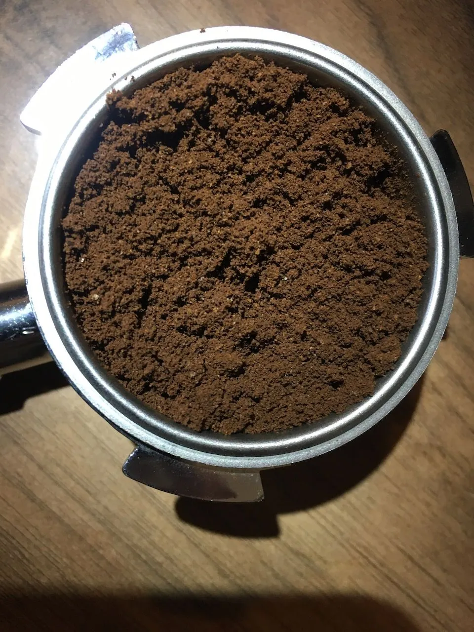

2. The grounds coming out of my DCP are pretty clumpy at the espresso size range (image here https://photos.app.goo.gl/TcysTf3ZmQTQFDPD9). I am not sure if this is normal? I am using a needle tool to break up the clumps, but perhaps not doing a sufficiently good job of this? Could clumping be causing the channeling?
