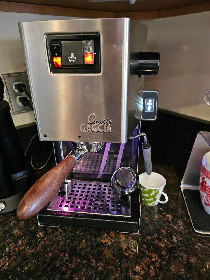

Gaggia Classic budget PiD setup: Barrista Gadgets install on Pre 2015 GC with HiBrew G5 conical grinder.

Found it used for $220 (plus $40 shipping). Decided Barrista Gadgets PiD fit my needs. Paired with my HiBrew G5 grinder I got for $162 It's a food budget base. The remaining cash will go toward another habit...trackday tires (pirelli Supercorsas) for my 2007 Yamaha FZ1 Anniversary!
Considered the Gagguino, but I really only need consistency, not experimentation so just PiD will work well. I have done automation on other equipment professionally (crystal growth, thermal processing et al) so I really liked the clean simple and compact aesthetic of Barista Gadgets install.
I've upgraded the portafilter and basket...and will likely upgrade the shower head as well. The 2011 GC was very clean inside and minimal use and scale. The HiBrew Grinder works very well for pour-over...much less fines than my old Breville Dose Control Pro. HiBrew medium grind range) for pour overs has replicated AeroPress and tasting evaluations I read in Sweet Maria's catalog tests...but we will see how it works for espresso...not looking fir miracles, but solid, reliable and consistent shots.

Wish me luck, just need to dial in my PiD...I use a PiD simulator, almost never rely on the "autotune feature" I find everyone's algorithms fall short of what I expect to be acceptable control behavior and predictability. I'll do it for kicks and then post wherevI end up !

So, a year later the HiBrew G5 grinder does some Fabulous pulls with a setting of 5 on Sweet Maria's Ten Speed Blend I roast on my home made Air Roaster. About 43G pull with 19.5G into my Portafilter . Takes 36 sec on average to pull a shot...crema is nice, but overall flavor is wonder if I roast to just past Second Crack (City++) Some of the beans are down the road into second crack, some have just gone past first crack...it's creamy, sugary, nice acid mix and all the florals that come with some of the beans in the roast...but no "Roasty" or bitterness.
The HiBrew Grinder is very consistent...even if I would like some more precision too dial in a grind...it's fairly forgiving. BUT one full number up or down and you're out of your sweet spot. That said, it's easy to go past, and come back to your nice grind setting and BAM you're right on the good grind again. VERY CONSISTENT...
My Gaggia Classic with the Barrista Gadgets PID is set at 98C and it's churning out delicious consistent shots at that temp.
