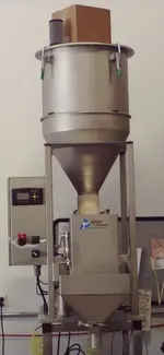

Check out Taylor's TE-10, that is what I purchased. I was interested in the Logical at first but never heard back from them. I compared Tridyne, Logical and another brand ( can't remember name ) to the Taylor and Taylor was the best as far as accuracy and maintenance. I added the larger hopper.
How high is the hopper? It looks pretty high...how do you load it?
