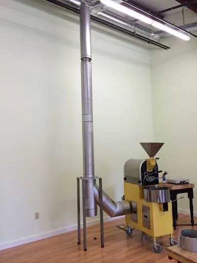

Nordfab has been suggested by many Roasters. I use Selkirk Metalbestos which the inside pipe is stainless with one inch of ceramic insulation and the outer pipe is aluminum. Positive pressure pipe. Listed under C1 and C2 on their website. It is pricey but the FD will never give you a hard time nor will you ever get burnt if you touch it. Simple to assemble. My pipe goes straight up. Did not want any bends. My plumber has knowledge of how to install this type and I have a roofer who installed boot on the roof. I assembled the pipe myself.
Here is a pic of the Nordfab pipe I use for my sample roaster. Really easy to assemble. This is all stainless but you can purchase aluminum. Priced reasonable.
