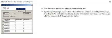

O.
sparrrowhawk
Jul 27, 2020
25
It is explained in the WMF service manual for WMF 800-900-1000 on page 75:
By clicking with the right mouse button in the white area a window is opened to set the service.
If „Set service“ is pushed, the maintenance counter in the statistic is set to zero and the message „Service recommended“ disappears in the display.
