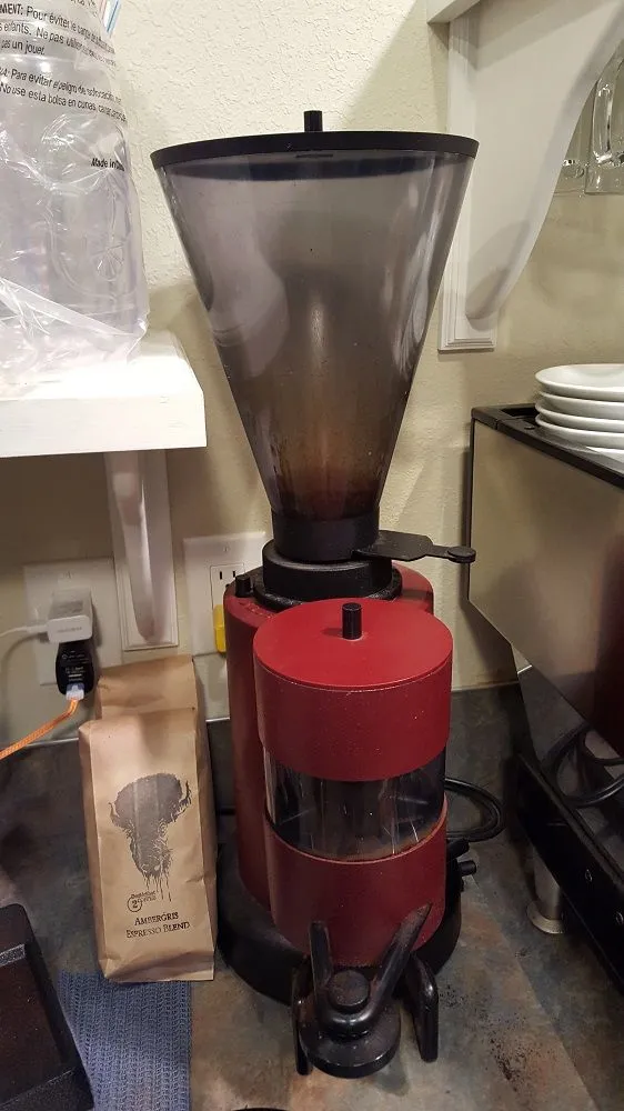

A lackluster grinder. THAT is a big problem because we use one of the best coffee beans in the nation (the documentary, The Perfect Cappuccino, shows DoubleShot where we get our beans - it happens to be local to us in Tulsa just a few miles away. Man, we lucked out on that!) and the L.M. is superb.
We began 15 years ago with a prosumer model at the time that was a Faema single group. It was okay for 12-13 years but it had a single boiler and was simply old technology today. But we also got a Faema burr grinder, large model like the shops in Italy used. Today it lacks because it has a fixed number of settings and the burrs are probably getting shot. It truly is the weakest part of our system.
The lust of the eyes makes me want one of the new La Marzocco vulcano grinders or something like that, but the money is just not justifyable plus this Faema, being a professional model years ago and used only in our home, is still going strong.
Seriously though, I do need to upgrade the grinder when we get some spare dough.
G
I would have NO CLUE what it's worth. I suppose the fact that it's a professional grade but only used in a home would make it worth more than a typical pre-owned Faema commercial grinder.
I have some hand problems and I do need to change to one that does a more automated dispensing but again, my desires are higher than my money balance right now.
Here's a photo of the grinder:
