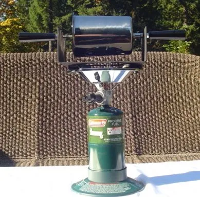

I do my daily roasts on a DIY stainless steel drum roaster similar to the FZ-RR-700. I roast 1/2 pound batches for the wife and I. It is so much easier than breaking out my 1 kilo Torrefattore which takes 30 minutes in summer and longer in winter to pre heat. I put the roaster over a Coleman 10,000 BTU camp stove and roast in 13/15 minutes. With setup and cleanup time added I am done in
30 minutes. I designed it last year and have roasted 200 batches so far.
That's a nice and simple setup. How do you make that thing spin? I don't see a hand crank, rotor, or anything... And what are the dimensions of your drum?
