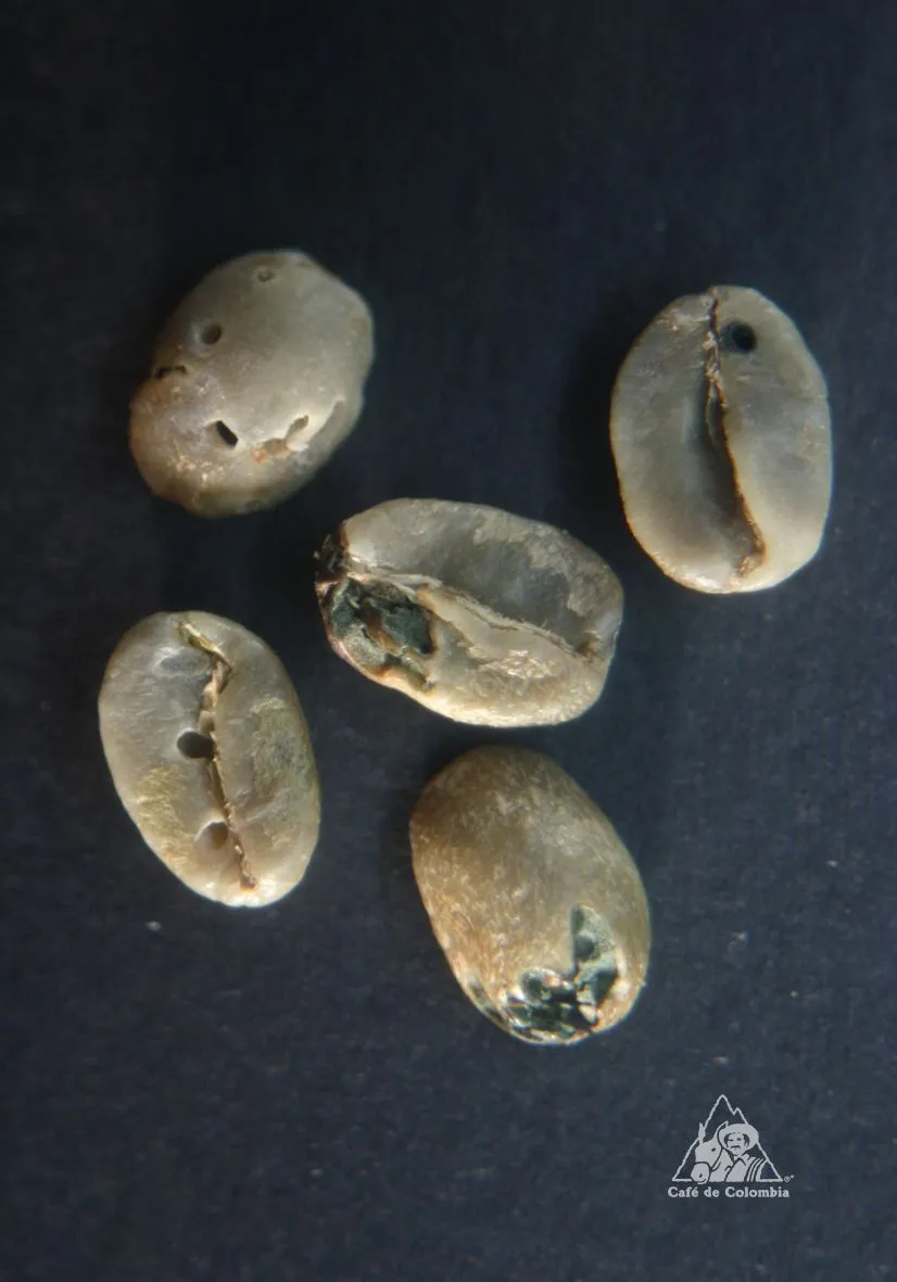

yes, you could be right. I took a look at it again. it does not look like a hole from insect. so it might not be CBB. however, it also does not look like it was damaged by pulping or any mechanical things...interesting...
here is insect damaged been photo.
It is different from the tiny hole in my bean. From your picture there is no color change around the hole. But in my bean there is a slight brown to black color change in small area around the hole. So maybe there are possibilities that the hole happened due to pulping procces?
Maybe i will visit my local farmer again to make sure of it
