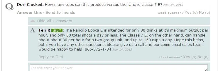

Hello. In addition to the "water and steam" demand, (again sorry for missing out the basic informations), I'm quite confused by this person's reply from SeatleCoffeeGear:
He says that he can Epoca E machine can only produce 50 total shots/day (I am assuming that this is per group head), so this would be 100 total shots/day. I am under the impression, that one shot equals one drink, say an espresso, cappucino and the like.
However, he mentions that it can only produce 30 drinks (or shots?) an hour. So basically, with a two group head, and an eight hour operation, this would be (2x30x8) 480 shots/drink per day, on a best case scenario. Why does he only say only 50 (on 1 group) or 100 (on 2 group)?
Please do enlighten me. Thank you!

I'm going to put and end to this crazy talk about shots per hour.
First and foremost espresso equipment isn't rated by shots per hour. One thing and espresso machine does very well is produce espresso. Your average espresso machine can quite literally produce 1 shot every 30 seconds per group. So 1 group can pull roughly 120, 2 groups can pull roughly 240, believe it or not they say your 3 and 4 groups pull 240 as well. The reason for that is ergonomics. Its possible to put 2 people in front of a 3 group but your constantly running into each other. This isn't efficient so they rate the 3 and 4 groups the same as the 2 groups on espresso production.
Now the reason why they say some machines are only good for 50 shots should have been said "the machine is meant for this much production volume." A 1 group Epoca S with water tank is only meant for very low demand. It wasn't designed for mid or even high volume shops. The boiler is only about a gallon and to top that off its only about half full. So you don't have a lot of water to boil to make steam. So that is why they generally say a 1 group espresso machine is really meant to do about 50 drinks a day. Yes it can do more then 50 but you notice the limitations pretty quickly and understand why they stated its only a low volume machine.
The larger the boiler the more steamed milk products it can handle before you can crash it with too much demand. So lets break this down by group size and to keep it simple I'll retain the liter size of each boiler.
1 group boilers tend to be less than 5 liters. Normally you find these machines running on 110 but you do occasionally run across a 220V machine every now and then.
2 group boilers run around 11 to 15 liters. Normally you'll find them 220V elements running wattage's between 2700 - 8000. Its a big gap on those wattage ranges and it creates a lot of arguments in the community but that's an argument for a later issue.
3 group boilers run 15 - 20 liters. As to date I've never seen a 110V 3 group but I'm sure someone has tried it in the past.
By the time you hit the 3 group realm your not really worried about espresso production. The point of 3 and 4 group machines is point more towards steam production. One of the trick questions I like to ask people who are just starting out in the world of coffee is how much water should be in the boiler at any given time to give you the most steam for your buck. Should you lower the amount of water in the boiler to about half the tank size to give you more room for steam or should you fill it to the max water line where there is almost no room in the tank for steam. I would say about 80% of them answer with fill it half way full so you can have more room for steam. That's the wrong answer. When you have a boiler that has the max amount of water in it that it can hold then it means you have that much more water that is boiling and turning into steam. In other words if you you drain your tank down to half you have about half as much water turning into steam.
I'm sorry this post has become so long winded.
So you can see that boiler size it what really dictates what your machine is capable of producing per hour. A 1 group Epoca (E or S) due to boiler size is going to have a rough time producing say 50 - 20 ounce drinks an hour. However a 2 group Epoca (E or S) will have no issues banging out 50 - 20 ounce drinks every hour. A 3 group wouldn't even break a sweat at 50 - 20 ounce drinks.
Now this is based upon your average espresso machine. There are a lot of other machines out there that take different routes to address these issues. As for now I'm addressing your standard espresso machine that is using a heat exchanger for espresso on a single boiler.

Fist off, I really appreciate your effort on answering my queries. The reason I am wondering about the shots in the first place was that in the forum they go around talking about 50 Shots per day on Epoca E1 while our local coffee shop has an Epoca E1 and they produced around 200 cups of coffee per day. I talked to the supplier about the shots/per hour, he said that you can actually produce coffee beyond 50 shots per hour, the problem is that you get an inconsistent temperature, so the taste will sooner or later be unsatisfying.
Now, reading your posts regarding about the boiler, it all makes sense now. Apparently, I'd still go for Epoca E1, this time with an informed judgment. I know it will not get me the optimum extraction, but the thing is nobody orders straight espresso in our town. All of them are either in Smoothie, or IceBlended or any milk based drink.
