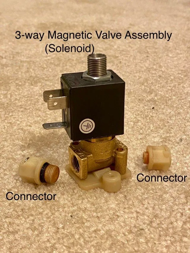

Cuesenart will not sell internal parts and opt for insisting on sending your unit to them and pay$$$. I found the part from <replacementparts.com>. It’s listed for a
Brevelli espresso machine and the part is a
“Solenoid Valve-Olab 9200H”. Below is a pic of it installed in my EM200. As the red marker indicates you have to reverse the large tube ends to make it fit.

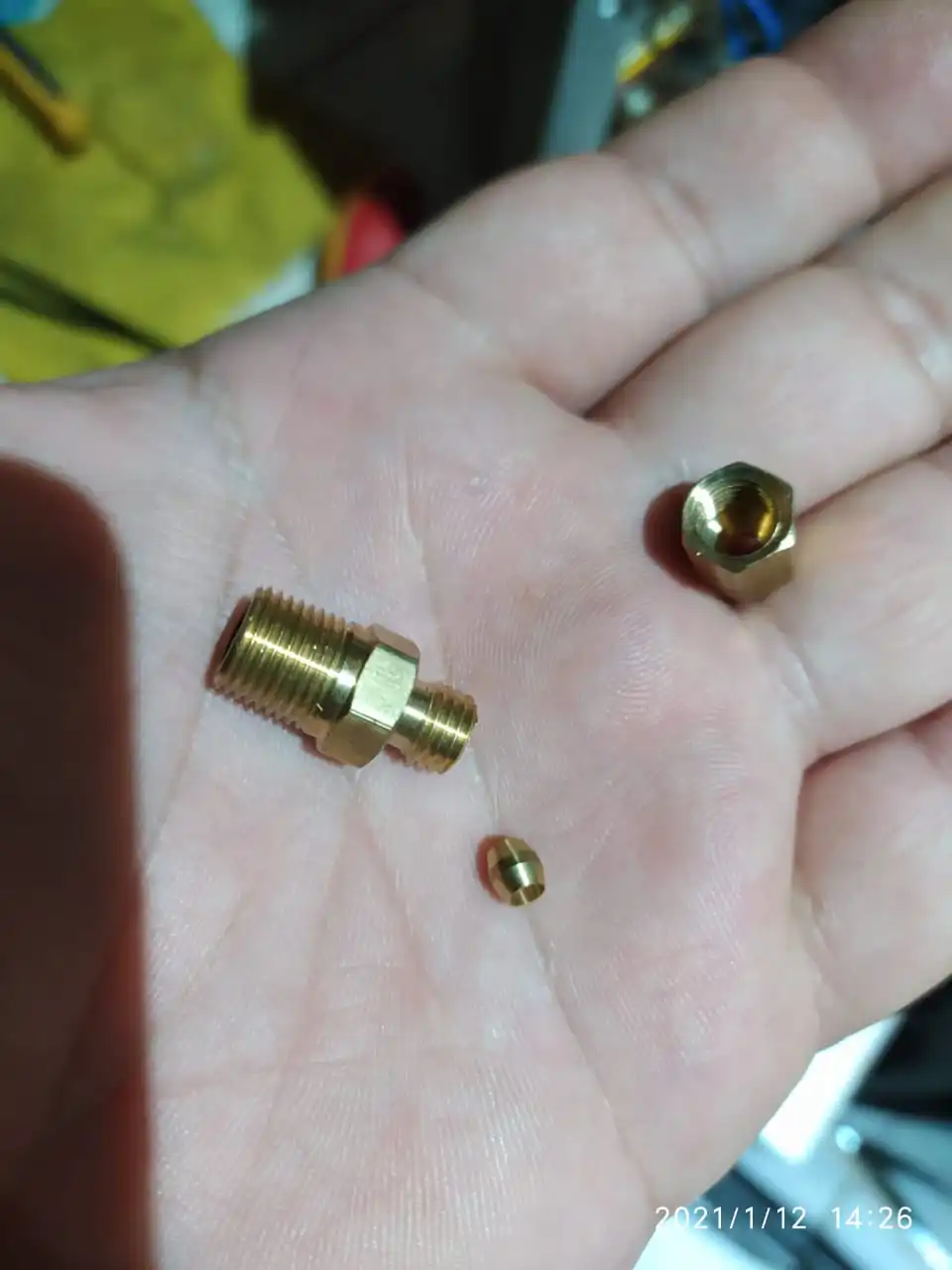

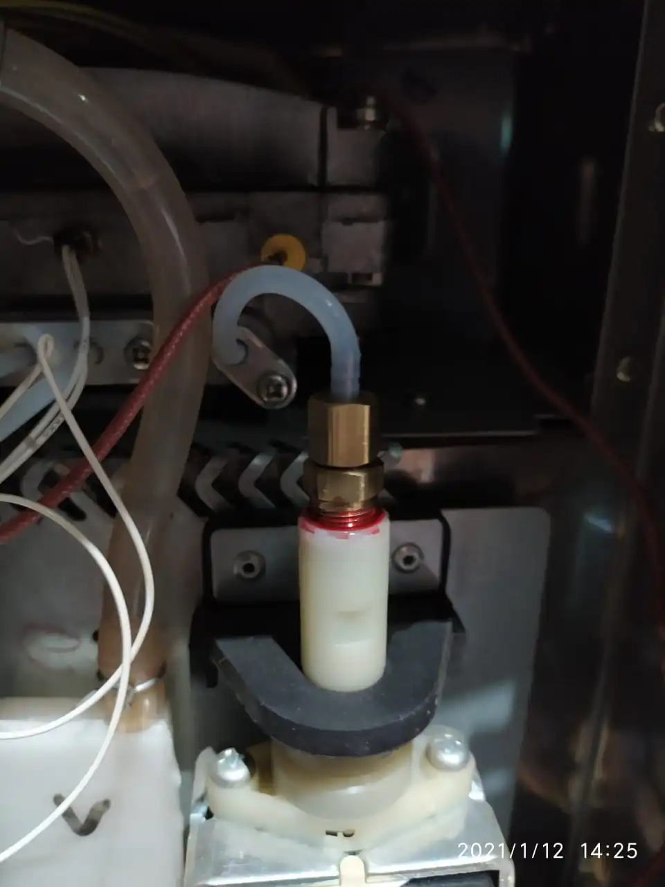

ok so i did fix the coffee maker cuisinart EM-200, i removed the teflon screw broken from the pump View attachment 10886View attachment 10888
as the one i found was too big and didn't fit in the spot of the broken one, i used a compressor piece i think made of brassView attachment 10887 i had to remove some brass from the hole as the 4mm tube didn't fit in.
You also have to remove the inlet and the ring from the original tubeView attachment 10889 and use the inlet as a stopper inside the new cap as the brass cone didn't work with this rigid tube.

REMEMBER TO PUT THE O-RING AROUND THE TUBE BEFORE TRY TO FIT IT INSIDE THE ORIGINAL TEFLON SCREWS OR IT CAN LEAK

This is a “Solenoid Valve-Olab 9200H” from <replacement parts.com> It’s listed as a Brevelli part

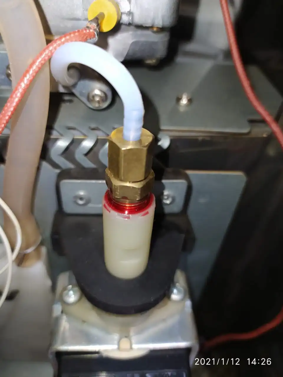

Here’s a picture of that part installed in my EM200. Works better than the original. Everything fits. You have to take the large hose off and literally reverse it’s orientation, or in other words, backwards from the position it currently sits in order for it to fit over the threaded spigot without adding an additional fitting.
