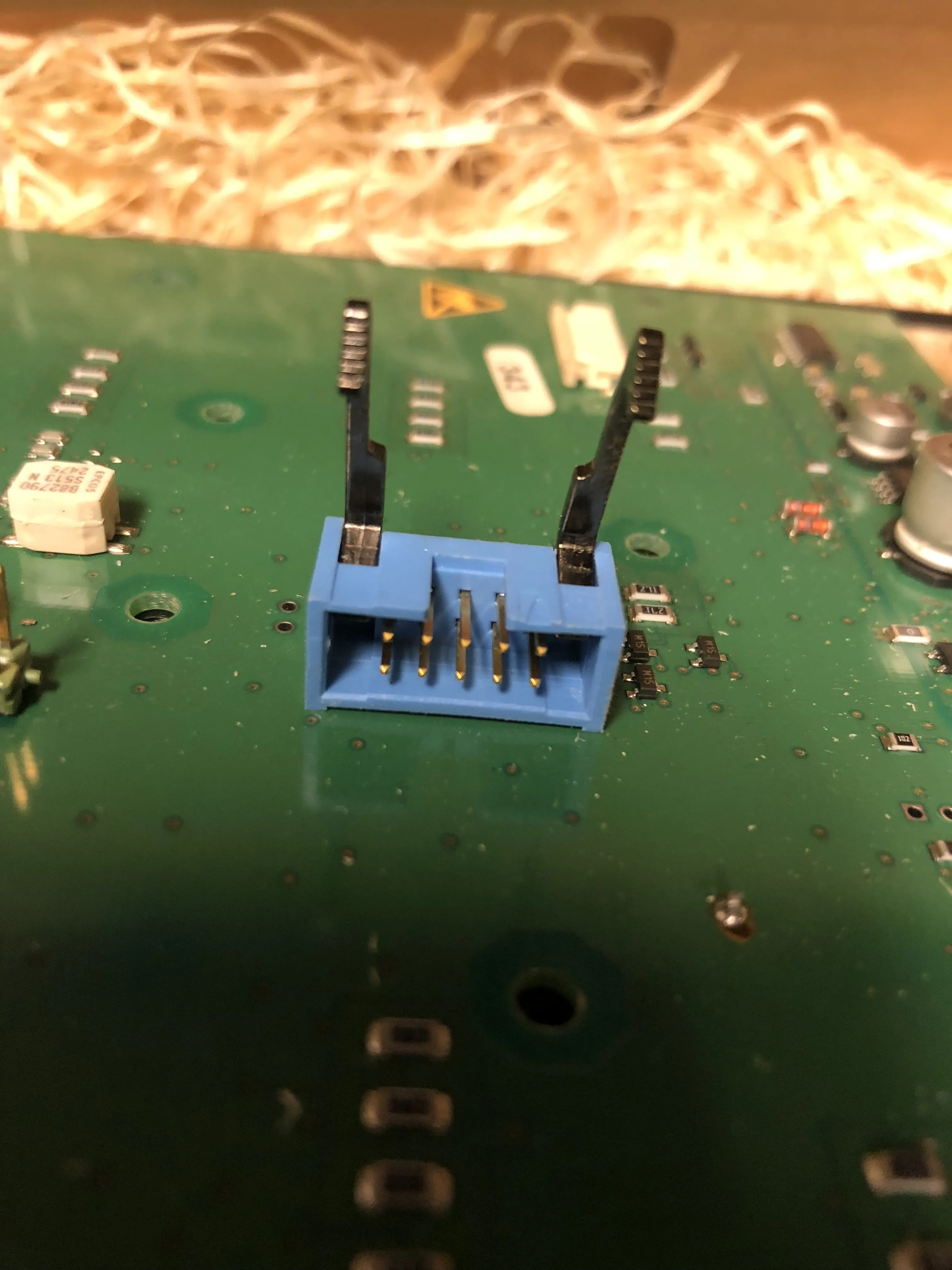

Ok! Sounds like you have a newer version, my front panel have a "usb header pinout" (google it for image) not a regular usb. Do you know how i would get this to work? have a look at the image, i have the exact same front panel.

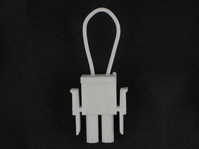

sonderwerk_steckergehaeuse_2_polig_bistro_cnf.webp What does the jumper cable do? we need a service tech. guy to explain stuff asap.
Nothing special...
Its a jumper to be used on the Bistro machines so that the machine can be run and used with the lid removed, this will stop the engineer getting the "Manual Insert open" error as this error will stop the machine functioning.
View attachment 8716 What does the jumper cable do? we need a service tech. guy to explain stuff asap.

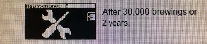

Ok so yet another problem, i have reach the 2year service blah blah.. image1(2).webp.
How do i close it down so it stops showing?
Hi,
If nothing else works for that error, I think simply setting the date on the maschine a year back would fix it. It did that for the descaling once and it worked.
I have the motherboard without usb. Do anyone know how the data cable should look and where/how to connect it on the motherboard?
THANK YOU!! Setting the date back at the machine worked perfectly :-D
Yes, the data cable is a; "COM1 Header Pinout to RS232" (Its like standard serial cable for a pc motherboard)
You push the black block connector to the coffee motherboard. Then you use a "RS232 to USB cable adapter" to hook it up to your laptop with usb. And this is where im stuck, i have the presto konfigtool but i dont know how to get it to communicate with the coffee machine :(

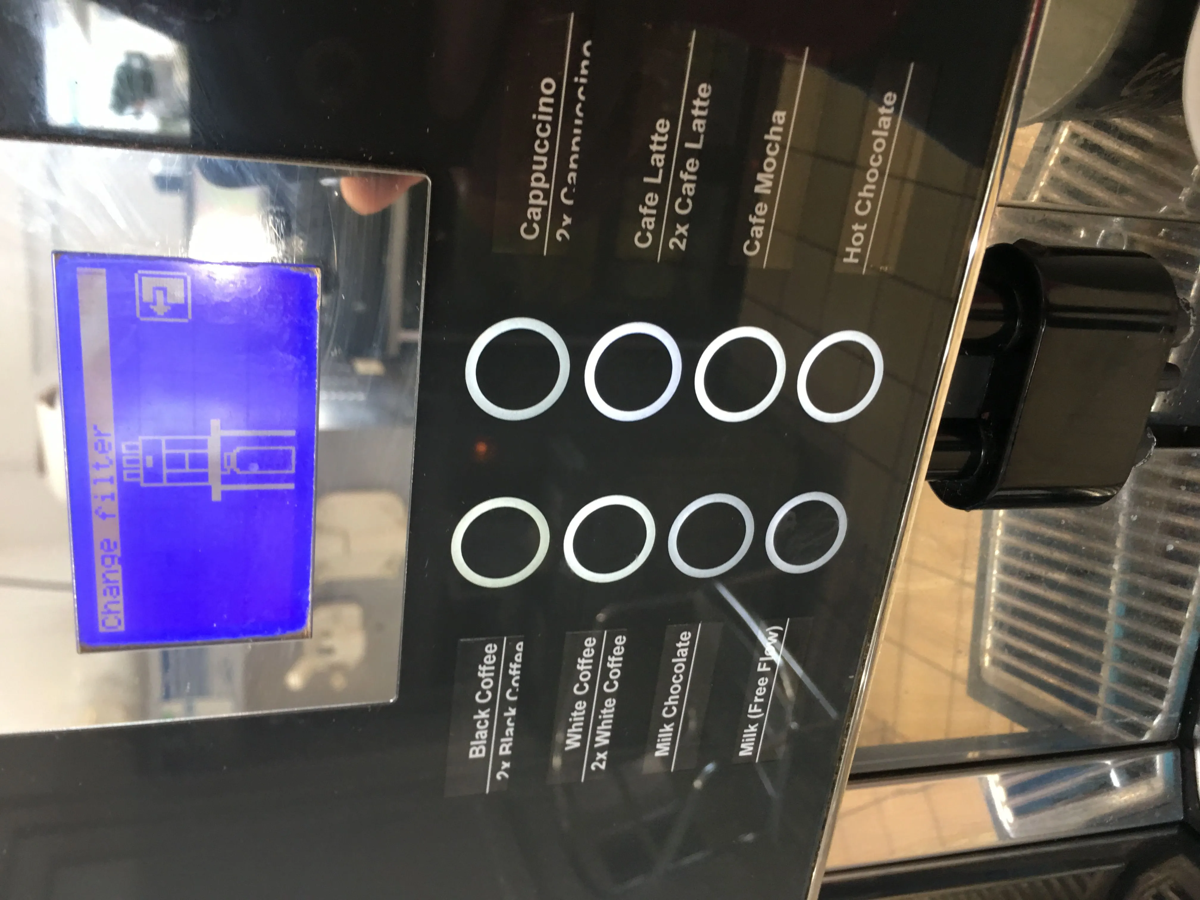

AB2C59C6-3720-4535-A9B0-58BACD9B8FF2.webp I’ve managed to work around most of the other issues by changing date etc to delay the discale error etc, I also change the filter and discale manually but taking the boiler Apart and feeding descaller though the heat eaxhanger coil etc... just can’t get rid of the annoying error massage! ��
View attachment 9689 I’ve managed to work around most of the other issues by changing date etc to delay the discale error etc, I also change the filter and discale manually but taking the boiler Apart and feeding descaller though the heat eaxhanger coil etc... just can’t get rid of the annoying error massage! ��
Every time my machine ask for descaling, i go to menu and run the descaling program and it disappears. i know some machines do not have that option, its "Locked" so only sservice people can do it. Is that your case or am i missunderstanding?
