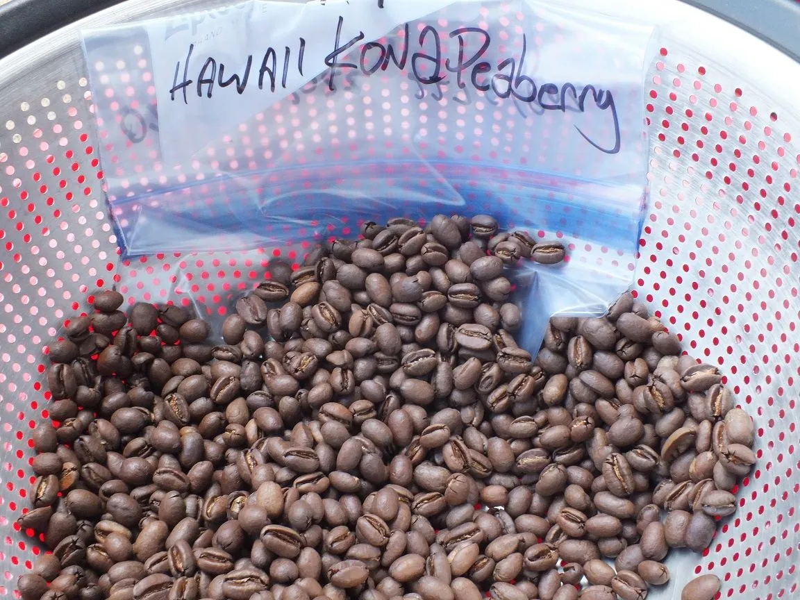

The Kona Peaberries were roasted, and I must say they give the Kona Extra Fancy (more than) a run for their money. I would say they are slightly preferable. I used the experience gained from roasting the Brazil Peaberry beans to better understand how to roast peaberry beans. The Brazil Peaberry beans were far less expensive. A good roast was achieved on the first attempt Kona Peaberry, which leaves a half-pound for a later roast.
The Kona Peaberry gave a clearly discernable first crack (which was far less clear with the Brazil Peaberry beans). The clear first crack on the Kona Peaberry gave a real leg-up on knowing how the roast was advancing. Upon roast completion, the Kona Peaberry beans "opened up" more than the Brazil Peaberry beans did.
I also ordered some beans from Sweet Maria's tonight. They are from Rwanda, Kenya and Ethiopia. They were selected for their respective "high scores" (89-91) and a sweet spot in the City to full-City roasting range. They were purchased in 5 pound bags with the intent of being used for half-pound "gift coffee" batches after they are roasted.
Below: picture of Kona Peaberry while cooling.

This required pre-heating to 402 F, stopping and removing the drum, loading the beans and quickly restarting the roaster to give the roaster a small bit of a head start to have a decent rate of rise. The Gene needs a preheating cycle to achieve a decent rate of rise. Even so, the beans were not at full yellow until almost the 6 minute mark. The temperature setting had already been elevated to 473 F at the 5 minute mark.
First crack was heard at 9 minutes and 30 seconds. The temperature was dropped to 437 F about 45 seconds after first crack was heard. The beans were dropped and force cooled at 12 Minutes and 30 seconds. Moisture loss was at 12.3 % and the Development phase was 24 % of the entire roast time (I could probably get away with shortening it a bit, but that decision will have to wait for the cupping in a couple days).

The Panama Geisha beans produced a wonderful cup, more floral than a Kona, but with a lime/cherry finish that balanced it well. I finally understand the interest in Geisha beans.
The Yemen beans produced a solid hit of chocolate, and solid body. It is a great drinking coffee.
