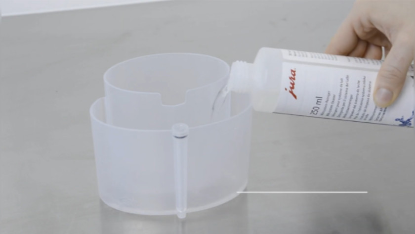

You need the milk cleaning pitcher if it's the newer model S8. For older S8, it's completely different. So you have to tell people the model number first.
