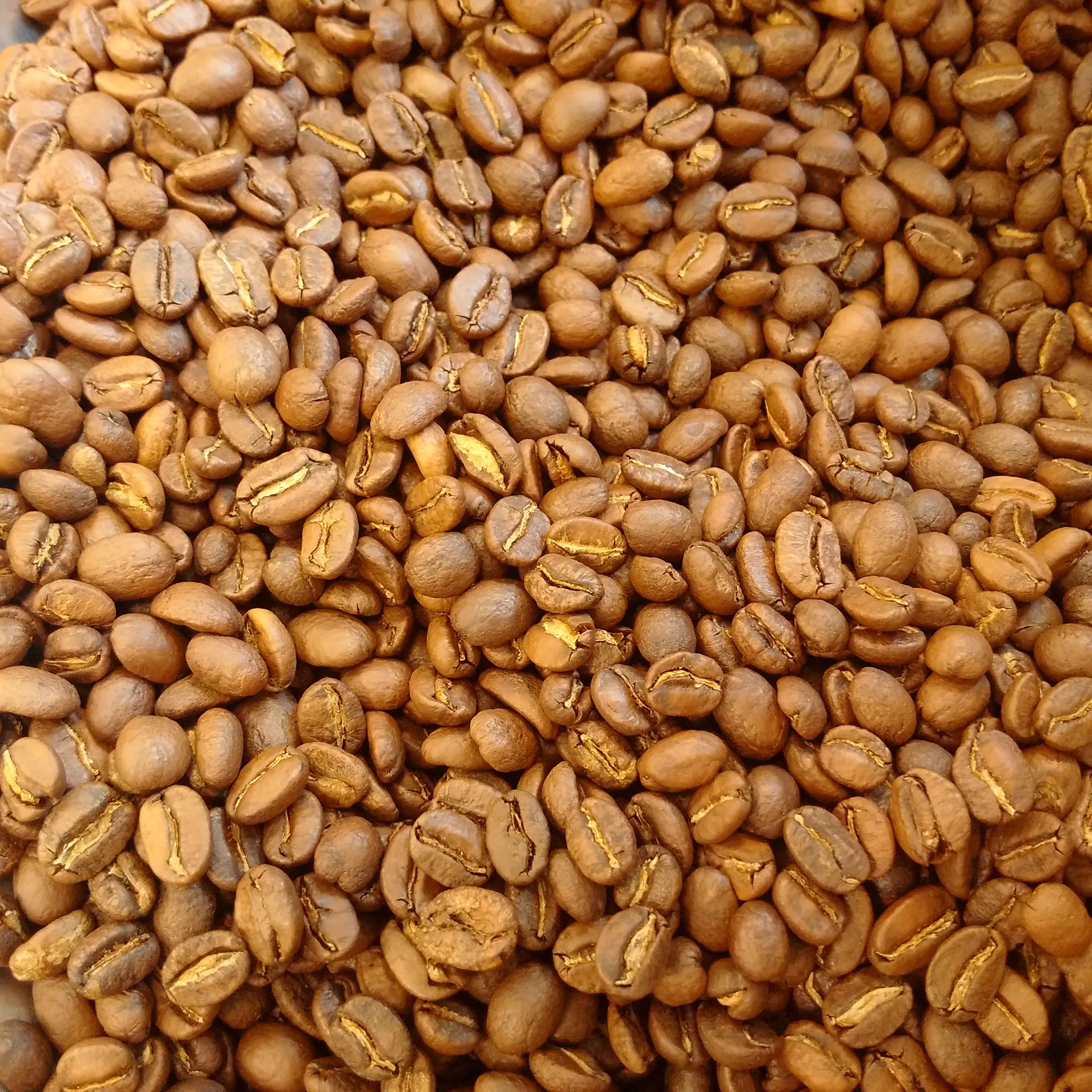

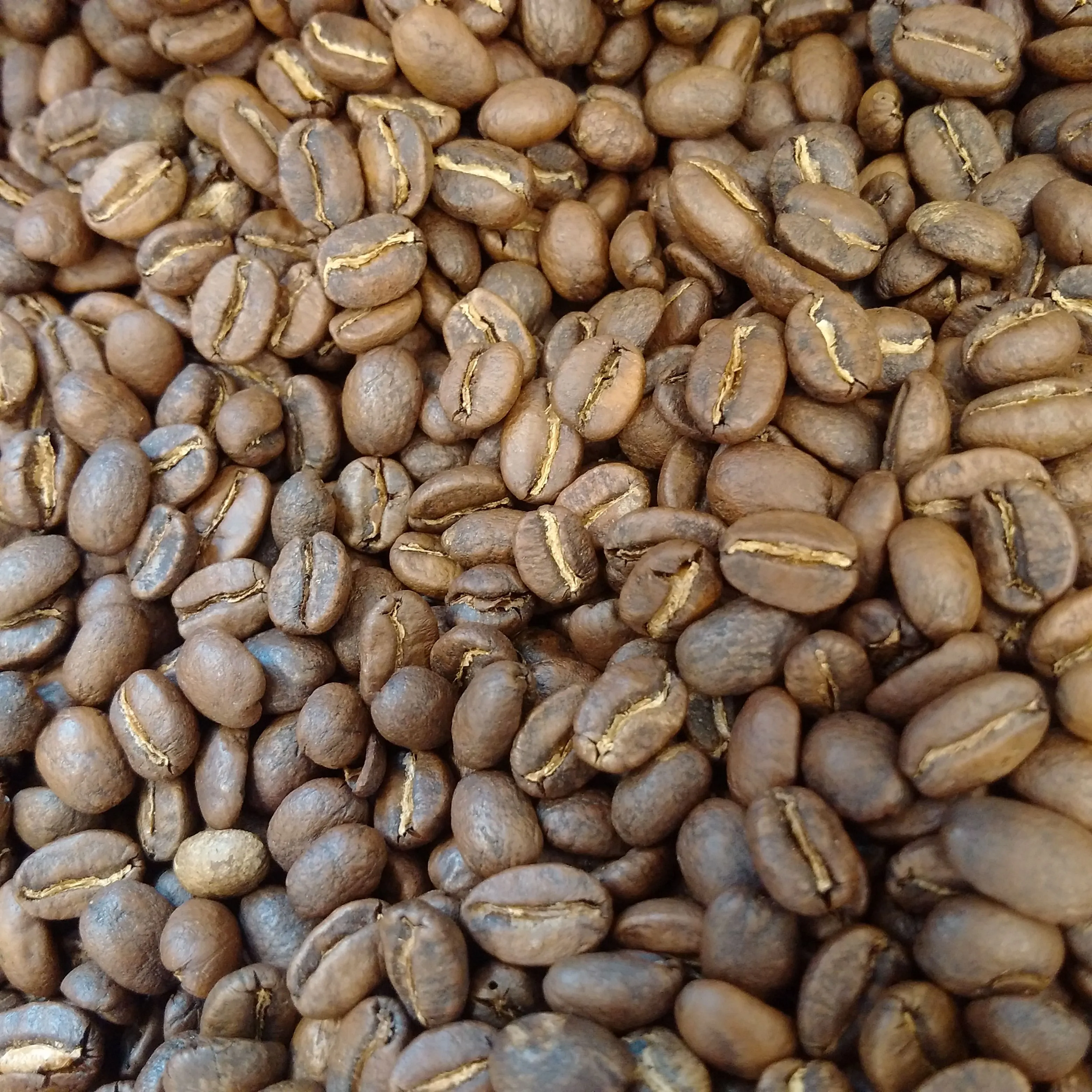

Hi Sweetyarra...
I don't mean to "kidnap" your thread I hope you don't mind me asking something
I have just bought a Solar I am not getting the “baked bread” stage it seems to run almost all the way to C1 on grass-wet - high acidity notes and then the “smokiness” starts. I feel as though there is moisture in the beans that the roaster is struggling to get rid of. I run a batch of Colmb Agustino forest the other day, charge temp 165C /329F end temp 205C 401F I let it run till well after what I thought was C1 and yet whenever I pull the tryer out there is still this smell of wet grass as if we are in the pre yellow stage. I am baffled….. I dropped at 16:30 min’ unfortunately I didn’t record the drum temp only beans temp (prob is in the door) it was 171C though drum was well into the three minutes after 205C so I assume 210-215.
would appreciate any suggestions ..
Many thanks for a fabulous forum

Hi Dave
Where are you located? If you are in Australia, maybe you can give me your number and I can call you?
Anyway, colombia coffee (as well as honduras, guatemala or the like), in my opinion, as they are high grown and hard bean, they should be roasted with final stage in 185-187 mark. (188-190 for darker)What is your target profile on this coffee? If you are going into medium to medium dark roast (full city?)Try to aim for 205-207* dump temperature.
The second picture without flash does not look scroched, they just look light. 198* is a premature temp for dumping. That is why you are getting light roast.
Also try increase pre heat to 170*
