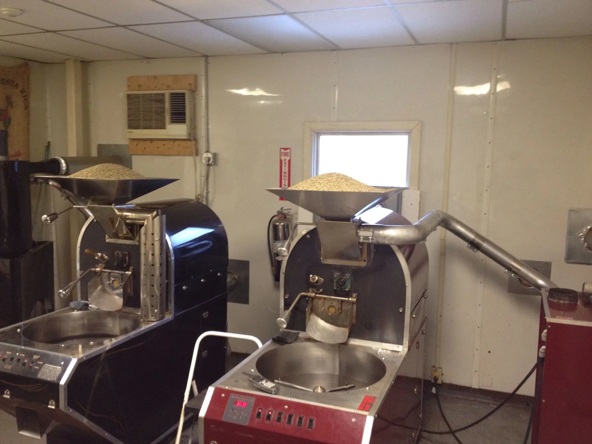

The green Diedrich is a good machine. I have talked with him about it and if you like Diedrich's IR, its a great machine.
I've looked at the green Primo online before...and having 2 Primo PRI 35 currently, the pictures show heavy usage despite the claim of being a backup machine. A TON of money for a used Primo! Do not be confused, it is not a Diedrich or a Probat
The red Primo I have an email into...want to know price on this one.
The big issue with these Primo PRI 35 is the pilot and burners. We modified the gas and pilot configuration and then had custom burners made and since (well over 1 million pounds ago), have had not 1 issue. The shrouding inside starts to break down after time and heavy use they will need to be removed and have some areas re-welded. My red has over 1.2 million pounds thru it, trust me I have had it apart a few times..
