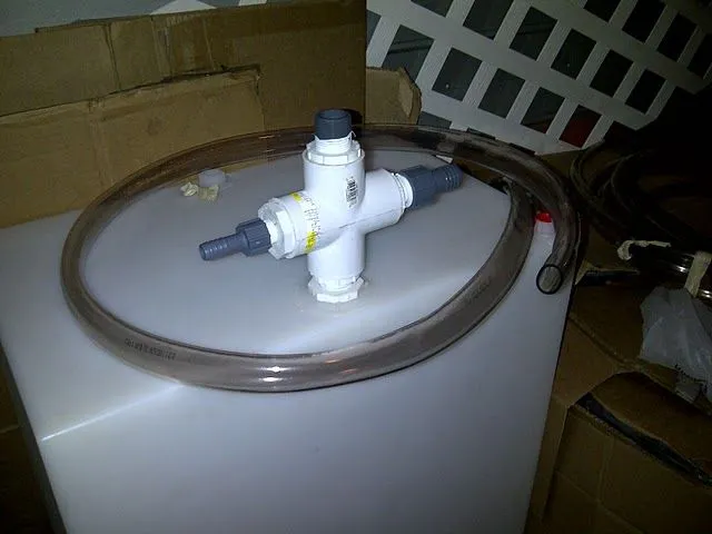

Original plan was to have 3 fresh water and 3 grey water tanks. The main reasoning for having multiple tanks (versus a couple larger tanks) is to fit them around the truck frame. Other reasons include: preventing the water from sloshing around and ability to tanks in/out of service based off needs.
With the revised plan only 2 fresh water tanks (25 + 35 = 70 gallons) and 3 grey tanks (40 + 25 + 35 = 110 gallons) will be used. In the state of Hawaii, and in most counties, grey water tank capacity needs to be 115% larger then fresh.

Have you had any issues with leaks? 2 of my tanks will not be readily accessible. They are going to be in a tool box that is bolted to the frame of the truck. I am not thrilled about this, but it is the most feasible way I thought of installing them.
grey tank
tool box that will hold 2 tanks and be mounted underneath truck
