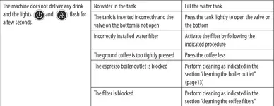

I'm afraid I might be coming to the end of my ability to troubleshoot. I'm not sure how to check connectivity (except to say that it is connected to the wires). I don't know if I know how to connect another DC power source :-( Perhaps I could put the wires from the solenoid next to it on it?
So, it's not all lights that are blinking/flashing. Once the machine is switched on, it goes through its heating process, when most of the lights blink, and then they go steady green, showing that the machine is heated. The manual has this in the troubleshooting guide (see pic):
