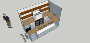

I'm right in the middle of converting an old horse trailer into a mobile bar/coffee trailer.
My original plan was to have a compact 2 group machine that I could take out the trailer when I was running an event where it wasn't needed. However the more I look into it the more i'm realising that these machines aren't really designed to be moved about, disconnected, reconnected etc etc. First, if anyone has any input on this that'd be great?!
I've attached a picture of my layout below. I won't have mains water obviously. I'll have a 25 litre barrel under the sink for fresh water and another one next to it for waste.
I'm planning on cutting a hole in the countertop under the espresso machine to run plumbing to the barrels under the sink. What connections, pumps and adapters etc do I need in place and does this seem like a feasible plan?

You are correct... I think it would be difficult to continually connect/disconnect. Not only are they typically pretty heavy (especially when full of water) you have to disconnect water supply / drain & power. I've seen people use a small two head machine (typical) or run two single head machines (i.E. Rocket 58). Pros/cons to both setups. Obviously a single head would be easier to move but your probably still talking 40-50+ lbs.
Regarding water supply... 25 liters seems small to me. I don't see any plans to do provide batch/drip brewed coffee - are all of your drinks going to be espresso based? If so, plan on plenty of storage for milk. I sample my coffees (batch brewed) in 2 oz cups at a farmers market on Saturday and go through 3-5 gallons in a day. You would also need a grey/waste water storage.. check with your local health dept. Typically it needs to be 15% larger than your fresh water supply. You will also need a 3 compartment sink / heater and account for water use in washing dishes / hand sink.

I can very easily adjust my plans to have 2 x 25 litre containers for fresh water and I will always be trading close to a water source. I might do pour over but I'll mostly be focussing on espresso based drinks due to the size of my unit. I have factored in plans for a waste water container under the sink as well. I was planning on having a 2 part sink, why would I need a 3 part? I'll definitely be installing an over sink water heater. I have a 208 litre fridge and coolers in my truck so plenty of room for milk.

To the question can you get espresso machines that you can take in and out. The answer would be yes. You could put in a couple high quality home machines that could be portable. There are major downsides to that in how quickly the recovery time is between drinks and I would not recommend it as it is going to be very limiting in how many people you can serve at an event.
As far as connections that will depend upon the machine you choose. Just make sure you get a quality, easy to change filter between the water sourse and the machine.

To better understand the connect/reconnect issue... most people use a pump like the video to pump water from your tank to espresso machine. You obviously have power and drain. Certainly you could move/in and out but I would think it would be a pain.

Accumulators are used so your pump is not constantly turning on/off... essentially like a small 'buffer'.
Regarding your second question... the machine must have a internal water pump. Not all water pumps can create enough pressure to suck water from a tank.
I can add a bit of info as my wife and I operated a full blown mobile espresso setup for a handful of years.
An accumulator tank acts like a pressure tank with a well/pump. As stated above it maintains line pressure so the pump isn't constantly running, but I don't think it's necessary. The setup we had was fed by 115 volt ShurFlo pumps that had pressure switches built into them. They did a great job of maintaining pressure. Had 3 of them... one for the sinks/hot water heater/2 group espresso machine, one for the icemaker and one for filling the TWO 40+ gallon fresh water tanks. The 2 group machine had an internal rotary pump and the entire setup just worked well.
