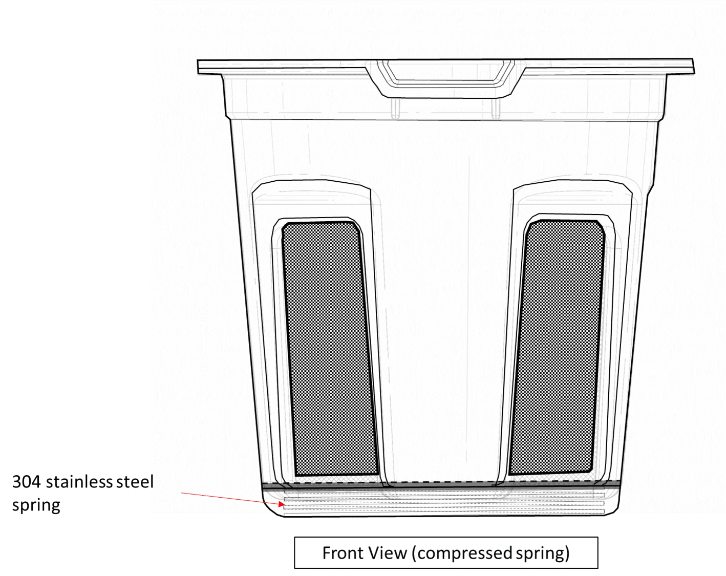

Thank you for the reply! If your k-cup had an adjustable bottom piece that could 'push' the coffee out, do you think you'd prefer that?
It would require a precision fit between the bottom piece and shell. Othewise it would leak water which was not ran through the grains, resulting in a thin cup of coffee. In theory, such a part could be machined (but not formed/moulded from plastic, which lacks the precision). As coffee residue and fines form a deposit, it would be problematic as well.
Perhaps these limitations could be overcome with a rubber seal, some food-grade O-Rings are rated at 250 degrees F. But once again, these features would make the refillable K-Cup rather expensive.
Interesting. Thank you for the information. I appreciate your feedback.
Thanks for the reply. My issue is getting the bulk of the grinds out of my K-cup. I find I have to hit the K-cup quite hard on the side of my garbage can to knock free the grinds and sometimes it makes a mess. Do you have this issue as well?
What are your thoughts on having an adjustable bottom piece on your K-cup attached to a spring that could 'push' the coffee out through the top (as seen below)? I am thinking about getting some of these custom manufactured. Do you think there would be interest in this?
