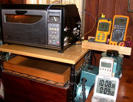

Here are some links that may inspire or help a little. Posted the pic, because I was amazed at this set up!:decaf: Check out the switches on Behmor side panel!
Homeroasters.org - Discussion Forum: My Behmor Experiences Over Past Year
Behmor modded
CoffeeGeek - Coffee: Home Roasting Talk, Behmor modification
