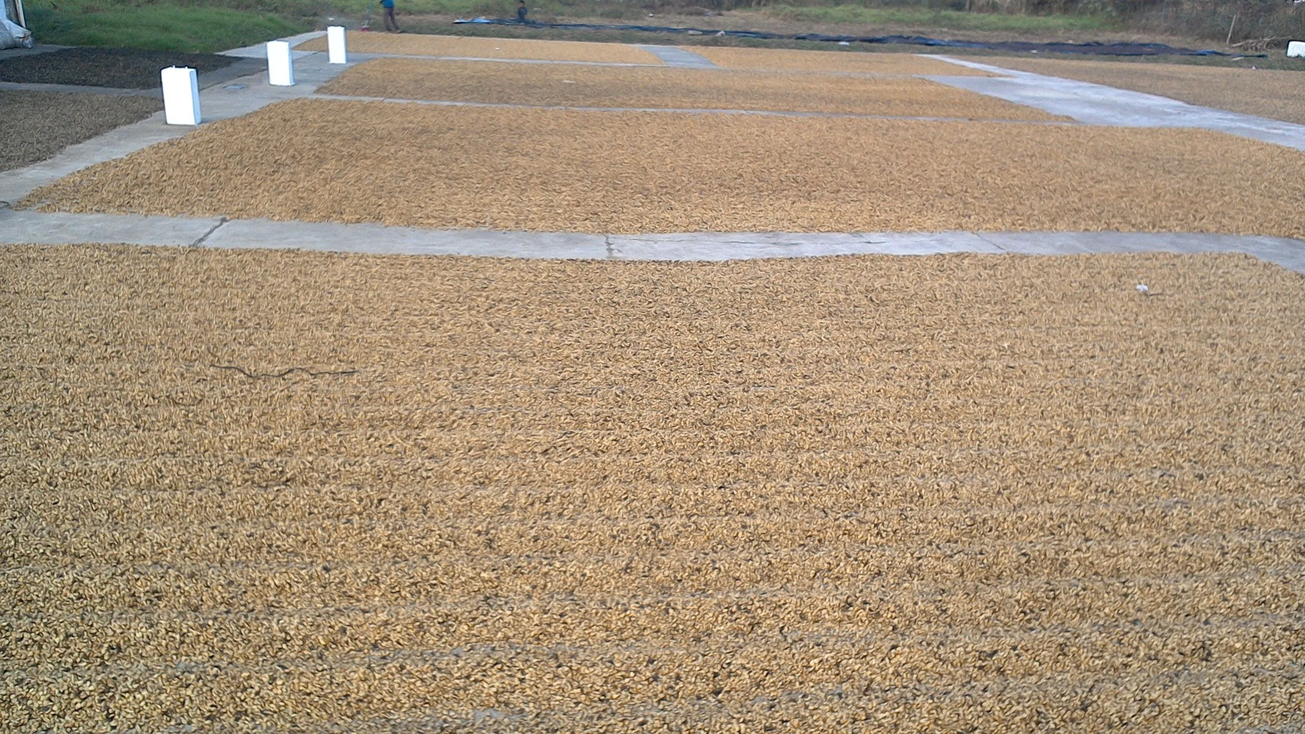

Below are the photos from one of Antigua Guatemala farm that we represents, but NEVER SOLD THEIR COFFEE to our customers due to over fermentation problems that they just can not get over... This farm specialize in Black / Red / Yellow honey process and Natural process, but it is not clean! Attached are some close-up honey processing bean photos, so you can tell they are not clean...
