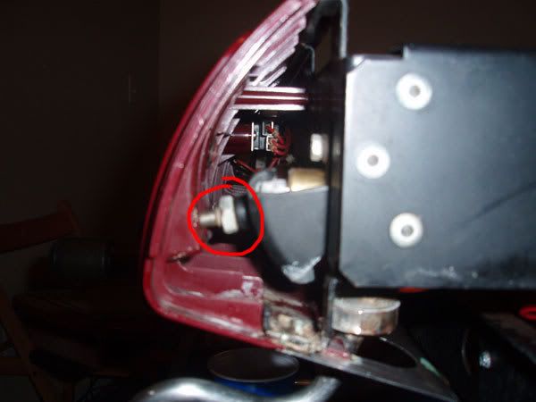

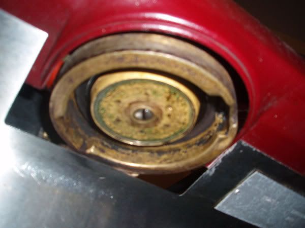

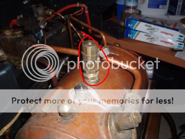

I''m working on a Faema Due and there are a few parts in specific I need replaced. (pictured below) The spring loaded safety valve on top of the boiler, something at the top of the steam wand (it leaks very bad), and the group assembly.
If anyone knows of a good place to get parts please let me know. Also, does anyone make rebuild kits? Working on this machine is starting to remind me of rebuilding a carburator and it would be ideal to have a bag of assorted wear parts to replace while I''m cleaning it.

Complete steam arm with valve runs around $75.00.
Safety valve and gasket is $30.00.
Group 8.5mm O-ring and shower screen $5.00.
Is your shower screen a round flat screen or does it look like a basket?
it's flat. for some reason those pictures didnt load, let me try again.
Thanks for the prices... is there a web site I should go to for that?
