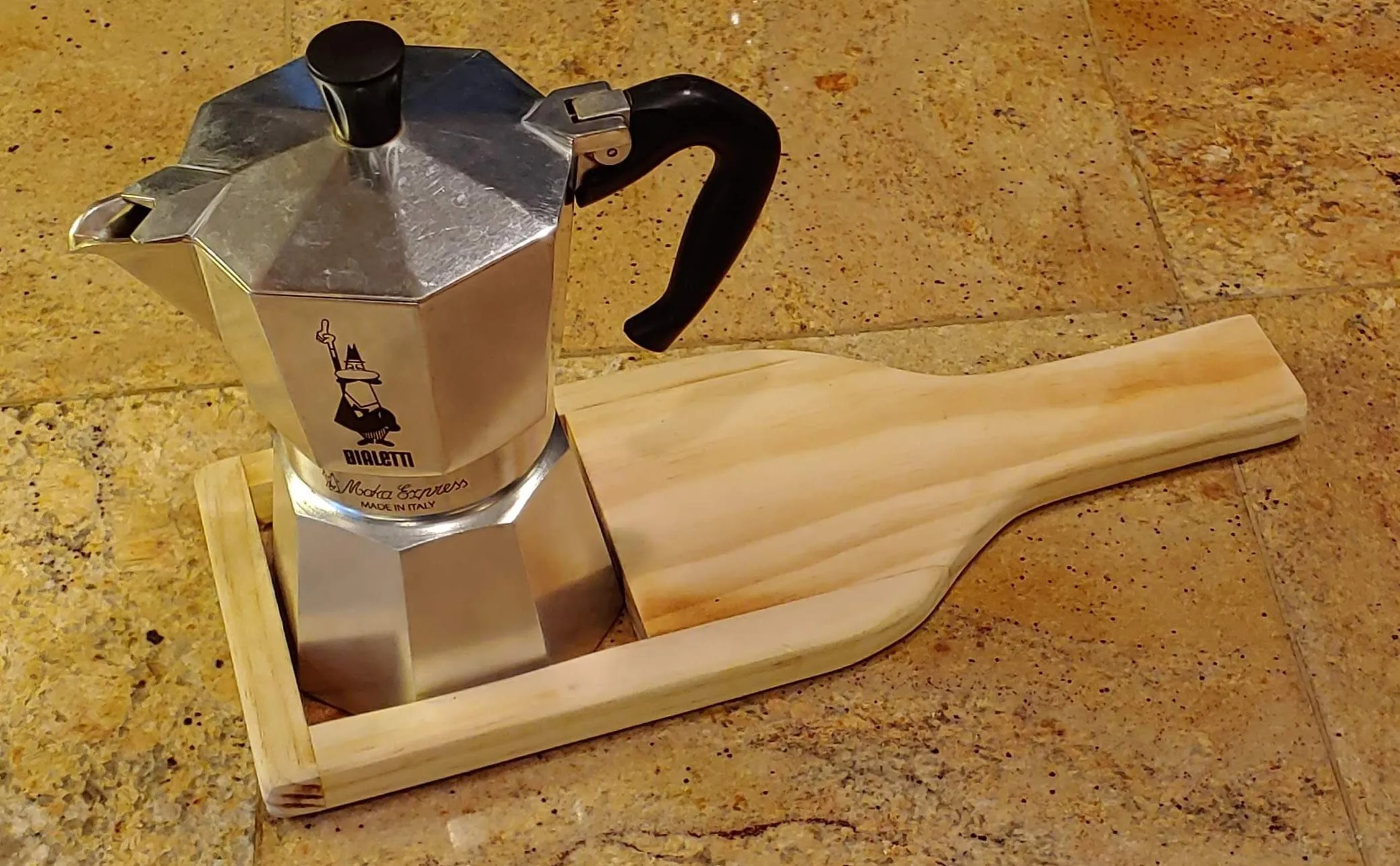

My experience exactly. As a Mechanical Engineer I am completely baffled by this, since the steam pressure inside the lower chamber is always extremely low (only slightly above ambient pressure outside the Moka pot), and there is no detectable leakage at the seal between the upper and lower chambers. Given this, it makes no sense that the behavior of the device should change so radically with a simple change to a new gasket. I solved the problem as you did by screwing the top on with extreme force. However, this made for an unhappy wife who could not then disassemble the pot. So I made a "Moka" wrench as shown in the photo. But then I re-purchased some new gaskets from Bialetti, and discovered they are fabricated from a different kind of rubber than the old ones---a softer, more compressible neoprene type, I believe. With these, our Moka works as it did before, with minimal force to tighten. The mis-behavior with the other gaskets is still a complete mystery to me.
fademi
Apr 3, 2021
Same issue here with my partner not being able to sufficiently tighten / unscrew the upper lid. She's very impressed by your elegant solution! Our latest gasket was the last of a multi pack of Bialetti replacements that may have been 3 - 5 years old - although the problem occurred with the then-new gaskets at the time of purchase and thus unlikely to be related to the rubber drying out. I will pick up some new ones and give it a go - although I'm loathe to futz with the pot now that it's back working. I'm hoping that after a couple of weeks of hyper-tightening the top that it will 'bed in' and no longer require such sheer brute force in order to produce a consistent even, slow brew.
I'm not a mechanical engineer, but I too could not understand why the new gasket produced the observed behavior. Leakage at the seal, sure, but the sputtering just didn't make sense as it seemed more like the result of a (non-existant) blockage than anything a mere gasket could cause.
